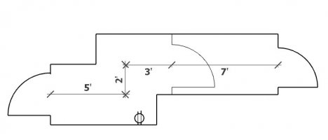

Hi there!
I have this condition... rough dimensions and layout, but here is a quick sketch.
There is only one outlet in this corridor.
If I'm reading the code correctly, that's all I need, because going through the door in the middle would be the start of another corridor... and that side is not 10'
Am I interpreting it correctly?
Just want to get another set of eyes on this :)
Thanks!
ps. I know it's not ideal but my question is in case adding extras is not an option.

Hallways. In dwelling units, hallways of 3.0 m (10 ft) or more in length shall have at least one receptacle outlet. As used in this subsection, the hallway length shall be considered the length along the centerline of the hallway without passing through a doorway.
Thank you and yes, the way I interpret that is to mean that the 7' hallway to the right would be considered another hallway and therefore not require an outlet (because it's not 10')... and because even if we took the entire dimension, the one outlet would satisfy the requirement.

Agree with the residential interpretation.
