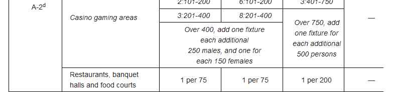

WE ARE IN THE PRELIMINARY SPACE PLANNING PHASE FOR A COFFEE SHOP/ CAFE IN OHIO. OCCUPANCY WILL NOT EXCEED 50 AND THE BUILDING IS 1410 sf. CAN WE PASS CODE BY HAVING (1) UNISEX / ADA RESTROOM?

As we go more gender neutral really it is more flexible to stay A2 and with the <75 OL I believe you can get away with 1 WC....Unintended consequence of political correctness? This does clash a bit with 2902.2 #5 maybe but anyway..."You have to provide separate, but can't identify as such"...Bad code....If your occupant load is less than 50 you would be considered a "B" occupancy. That will still require separate restrooms as you are over 25 occupants.

Not sure how your getting to the possibility of compliance with a single unisex RR in this situation. A2 requires separate men's and women's WC's for 0-75 persons of each sex. two single occupancy rooms would be compliant, not one.As we go more gender neutral really it is more flexible to stay A2 and with the <75 OL I believe you can get away with 1 WC....Unintended consequence of political correctness? This does clash a bit with 2902.2 #5 maybe but anyway..."You have to provide separate, but can't identify as such"...Bad code....
3. Distribution of the sexes is not required where
single-user water closets and bathing room
fixtures are provided in accordance with
Section 2902.1.2.

Correct....So if we are 1 per 75 "people" and we can't assign a gender...per 2902.1.1 #3 which then sends us to 2902.1.2......A2 minimum fixtures would be 1 WC per up to 75 Male and 1 WC for up to 75 Female.
Couple problems. Ohio building Code does not have that language. In any case the 2021 IBC would then allow you to use unisex restrooms but you would need to maintain the minimum fixture units so your going to have 2 unisex rooms in any case. There would be no compliance with minimum plumbing fixtures with just a single unisexCorrect....So if we are 1 per 75 "people" and we can't assign a gender...per 2902.1.1 #3 which then sends us to 2902.1.2......
