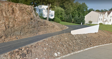

The IRC is based on the building structure not landscaping, though one might stretch the purpose like you are attempting, it is not the intent and one of the many reasons we have an IRC separate from the IBC.
Example: once you leave the building and are to grade, the IRC stops, so if you have a home that exists on to a front exterior landing, then down 3 steps to the walkway and then 15 feet across the yard to another set of steps, let's say 8, that go down to a driveway. The Model IRC only covers the landing and 3 steps without modification, not the lower 8 steps to the driveway, though many try to stretch that view, it does not.
Example Pic: Red arrow points to walkout to lawn area to the left
Let's look at another example, you buy a lot and build a home that has a natural rock fall at the end of the property that is 20ft, now that you built the home on the property, by your definition though the rock fall is existing and 100 feet away, the lawn runs right up to the edge. Because you installed the lawn which was not existing you created a walking surface between the two? I think not.
Unless the retaining wall is directly connected to the home, garage or patio that is attached to the home and the hardscape walking surface is within 36 of that drop, its out in the lawn and thus landscaping.
Just because you installed grass, does not mean you have a walking surface. And by definition not covered, the lawn mowers are on their own.

Once you exit the structure and are to grade, building code is done...unless you go in to another structure...then to grade and done.
So, you exit the home on to a deck then down to grass grade, IRC stops.
The retaining wall is not a walking surface and nor is the grass per the IRC, otherwise every inspector should be roaming every inch of the property for drops from grass, because the definition of guard says "from elevated walking surfaces"

I think the proposed language is going to have "walking surface within 3' " and hopefully some other tweaks....
That is the threshold I use now, but it has to be a walking surface within that 3'. I like the more specific "pedestrian path" language too. As TBZ is saying, lots of things can be walked on, but that doesn't make them walking surfaces from a code perspective.

I look at the photos tbz posted and can't imagine the expense and public outrage that requiring guards atop them would entail.
I hope supporters will show evidence in the form of injuries and deaths resulting from falls from retaining walls, not just a couple of documented incidents and anectdotal reports, to justify this.
