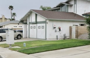

This picture is a house I passed by on a Saturday while I was yard sailing.

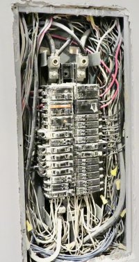

The next pictures are inside a laundry room of a large home that an addition was being added to. The family of five included preteen children. The contractor told me that the panels had not been left open for six months as I suspected. He claimed that he opened them on the day of my inspection for a final. I had not been there previously but there was evidence that the contractor is a damned liar.
And for the record, I did condemn these breakers. I was not sent back for a followup inspection as I was filling in for another inspector.

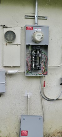

A surprising part of the typical idiocy is that the dead-front is removed and that's bad. But they make it worse by leaving the door wide open as well....that I just don't get.... but rest assured that every picture that I have shown is exactly how it was when I arrived. I did not stage any of it and in many cases the door was also removed.
The door on this panel would not close. It was bent and stuck in this position.
I called the solar company to voice my displeasure. The lady that answered the phone assured me that they would never do such a thing.
