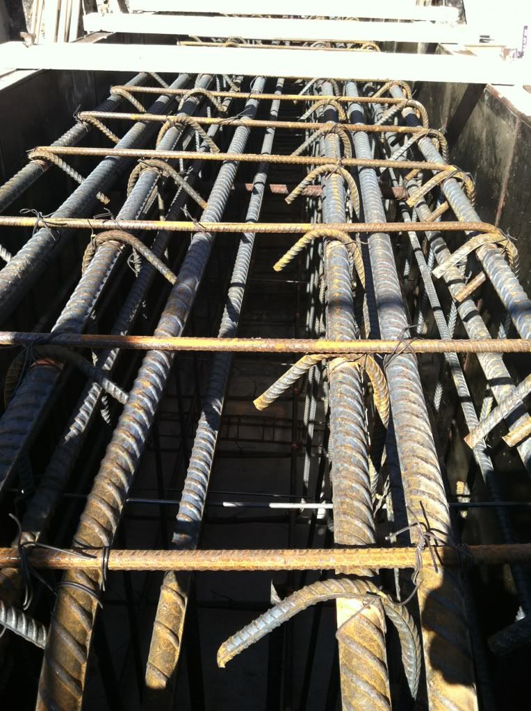

Reverse Grade Beam
13,321
These are going to span from footer to footer on a 4 story commercial building at the base of structural steel supports. The heavy rebar is at the top of the grade beam to protect if from deflection UPwards.
