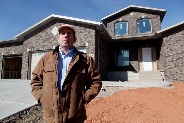

Bill Huebner is building his dream home on Enchanted Pines Drive and at the same time battling the city over being required to install sprinklers for fire prevention. Huebner is seen here in front of his home on Thursday, March 8, 2012. (Kristina Barker/Journal staff)
