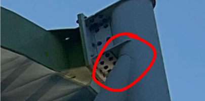

I read about head also, considering it's a fixed location ride, not a traveling one it seems like the engineering failed somewhere along the line. The forces for the ride which tops out at 325 feet have to be phenomenal.
I saw a video of the ride and that crack and the track moving separately from the column. Seems some part of the engineering didn't fail considering such a major "crack" didn't fail catastrophically. Luckily not a RUD (rapid unplanned disassembly).
The evening news has a video of the crack opening up as a a car loaded with people crosses. It is a complete separation… you could toss a cat through the gap.
The culprit will turn out to be value engineering. The structure will be torn down.
No injuries. System worked.
I fail to see how the system worked when it was a customer that pointed out the separation. There is a picture, that I can't find-- but have seen, of a crack taken some days prior to the failure. That crack was visible on the left side and the picture was taken from a distance.
Reports stated that it took an hour to shut down the ride after the customer reported the problem to a security guard.
Either there was a defect in the steel or there was a defect in the design.

The system worked because a significant failure did not result in injuries or fatalities.
I agree with your statement. However, it would be just a matter of time before there would be a catastrophic failure if this had not been reported.
The picture below is from a week earlier when it was just a crack.
"The park says it inspects its rides every day" 7 days of daily inspections and it was not noticed? Somebody wasn't doing their job properly.
I think we are talking apples and oranges. The system as designed worked because there was no catastrophic failure or RUD. The maintenance system failed to find this issue. The design compensated for the lack of adequate maintenance and inspection. This is a people problem. With that being said, knowing this fails over time should result in a redesign.

At this point we are all just speculating on what could be the issue.
It could be as simple as the foundation not being 100% stable and settled a little producing forces in another direction not accounted for nor planned for, nor seen.
As to the inspection process, that needs to be looked at and the park needs to explain how this was missed as a crack, not to mention total separation.
I would be interested to know if they did a full 3d scan of the ride when it was installed and then again now and see if anything moved from the original placement.
Pretty sure who ever built this and installed it, is looking hard at any other rides they completed since this one was installed and their insurance carrier is the one taking a good look, the park is far less concerned than the designer and the manufacture is right now.

The design of roller coasters is mostly driven by fatigue issues. When dealing with fatigue issues if you have enough repetition of the load the magnitude of the load does not need to be very high to cause cracks to grow. Often what is more important is the details and fabrication of the members. The building code was not developed to deal with fatigue issues.
