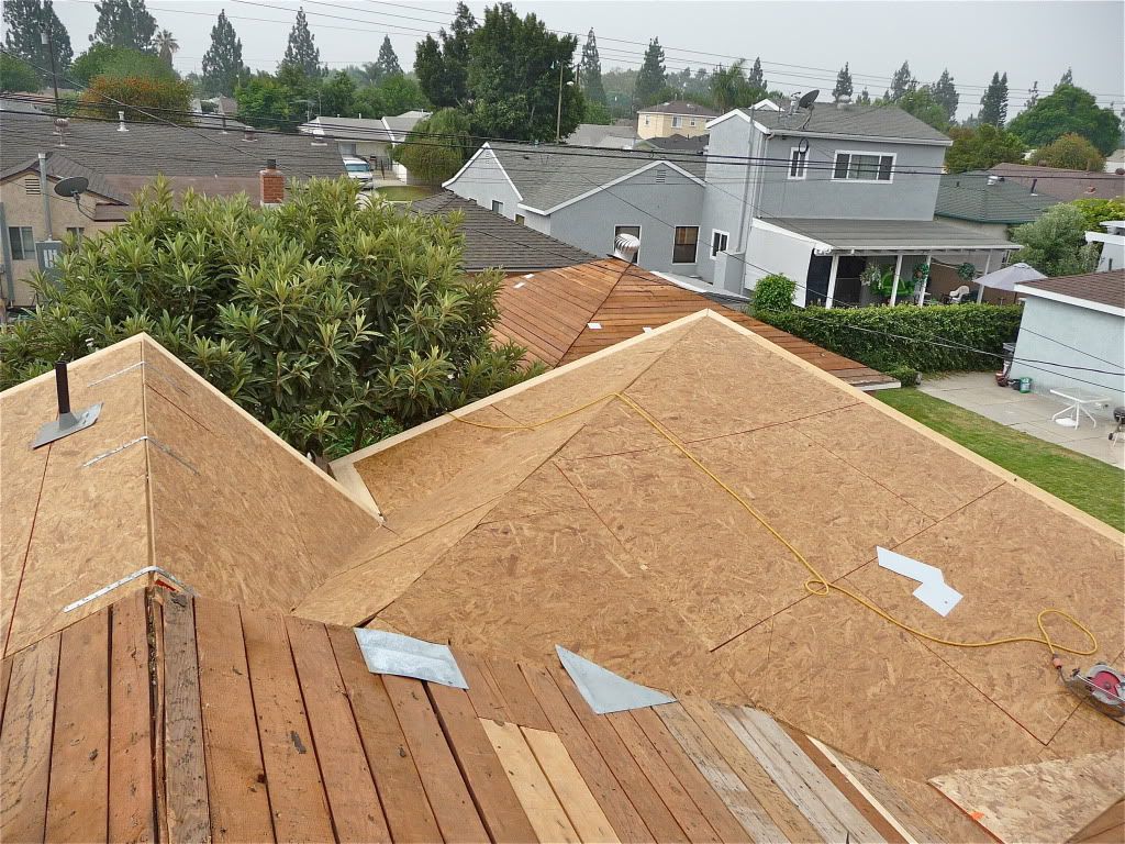

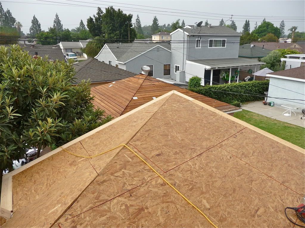

There are some dramatic curves.
The line under his right foot should be straight.
The hump is downhill from the dip in the picture above.
MtnArch said:
But I can draw it on paper and it looks right!
The contractor battled to keep it and then wanted to frame another roof over this roof. I won the war and this roof came off, down to the plate line. The work was correct the second time around.
