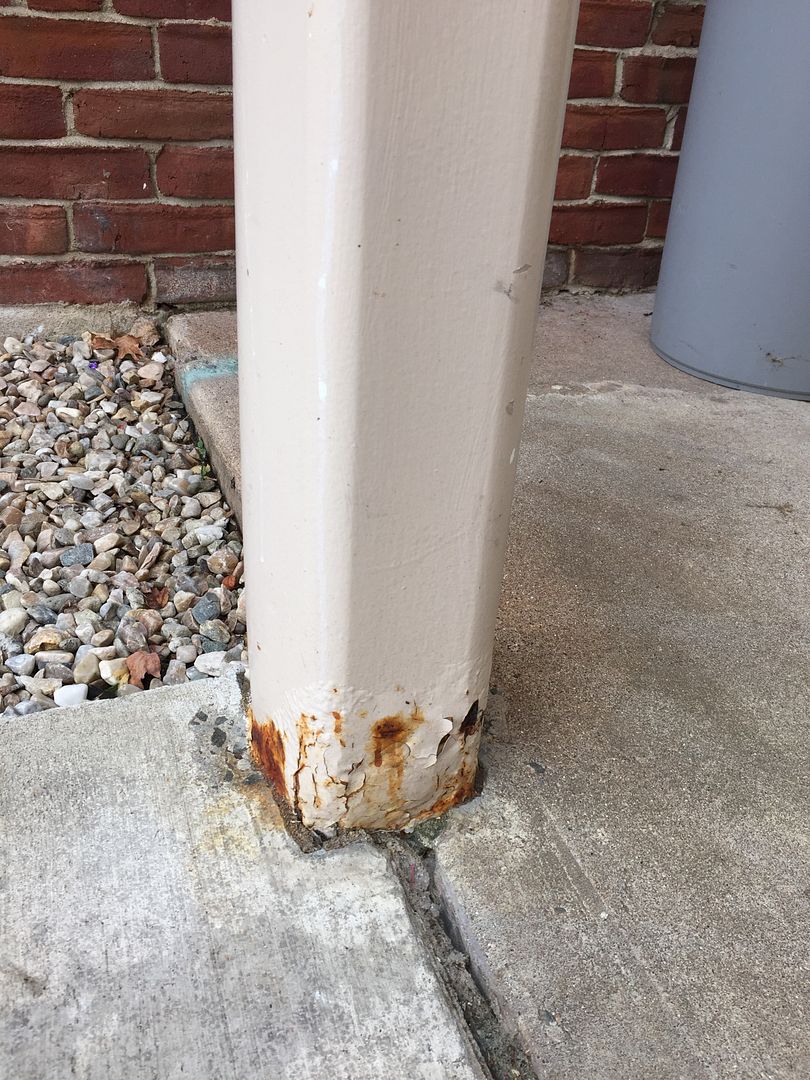

An inspector that thinks outside the box here, is negligent and personally liable....You ever see a plain steel tube column exposed to weather? Ohhhh....That's right....California doesn't have weather...
This is what they look like in 20 yrs WITHOUT water running through them...
And let me tell you about galvanized drainage pipe, few and far between are the ones I see that have not been halved in ID by rust over 30 yrs or so....
