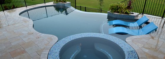

We have a project we're working on with a rooftop infinity edge pool right at the edge of the building. It will be at least 42" deep but I'm assuming that wont be enough to meet railing code at all since you are so buoyant. I am not getting a clear answer from the municipality, or architect, or pool company. I want to know what is at least required in terms of a railing for a rooftop pool at the edge of a building. We have the water catchment at least on the side of the pool for the infinity edge and then I'm assuming a railing beyond that. How far away would it need to be so the railing is lower than the edge of the pool, 2'? How tall would the railing need to be if its about 6" away from the outside edge of the pool?
Swam in one similar last year and wondered the same thing. I looked over the edge and there was an area below that would "catch" you, probably not die in the fall, but certainly not ideal. The bottom line is the code speaks to walking surfaces. Not swimming surfaces or buoyancy. That is a tough one, I would want to cover my tail too, but not sure how much of a hazard exists, and not sure how to mitigate it.

A guard rail is not required, as a pool is not a walking surface.
1015.2 Where Required
Guards shall be located along open-sided walking surfaces, including mezzanines, equipment platforms, aisles, stairs, ramps and landings that are located more than 30 inches (762 mm) measured vertically to the floor or grade below at any point within 36 inches (914 mm) horizontally to the edge of the open side. Guards shall be adequate in strength and attachment in accordance with Section 1607.8.

And if someone is hell bent on saying that you can walk on the floor of the pool, then measure from the bottom of the pool.
