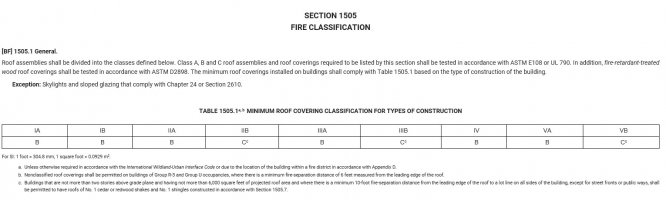

Do you feel that Section 1505, IBC 2015, is applicable to requiring a Class B fire classification for a poured playground surface according to ASTM E109 or UL790. This is the top layer of the roof assembly. Is there a case to be made that the “roof covering” requiring the Class B listing is actually the waterproof membrane that sits on the structural deck below the assembly? Might the rubber top layer be considered a “furnishing, playground or equipment,” or some other category which would be exempt from this requirement?

Most poured product manufacturer's are tested to ASTM D2859, which is a test for textile floor covering materials, and while helpful to know, they do not indicate testing to ASTM E108 or UL790, or give any indication of a Class B roof fire classification, which is what Chapter 15 of North Carolina Building Code requires.

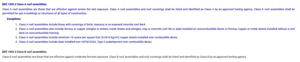

I have attached the NC code sections below.

I think it is the other way around, not because we put the playground up there. There is a roof rating that is required and we are trying to figure out if the poured playground is part of the roof assembly or considered separate. Section 1505 requires a Class B fire classification. If we place a poured playground surface above the roof assembly as the top layer, does it need to comply with ASTM E109 or UL790? Is there a case to be made that the “roof covering” requiring the Class B listing is actually the waterproof membrane that sits on the structural deck below the assembly? Might the rubber top layer be considered a “furnishing, playground or equipment,” or some other category which would be exempt from this requirement?

[BS] ROOF ASSEMBLY (For application to Chapter 15
only). A system designed to provide weather protection and
resistance to design loads. The system consists of a roof covering
and roof deck or a single component serving as both the
roof covering and the roof deck. A roof assembly includes the
roof deck, vapor retarder, substrate or thermal barrier, insulation,
vapor retarder and roof covering.
[BS] ROOF COVERING. The covering applied to the roof
deck for weather resistance, fire classification or appearance.
ROOF COVERING SYSTEM. See “Roof assembly.”
