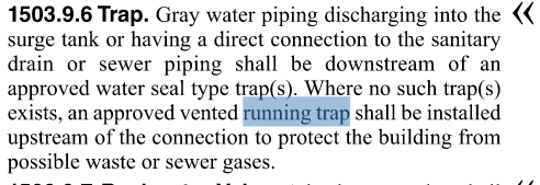

Is a running trap allowed?
I do not see it listed in 1002.3 Prohibited traps.
1002.3 Prohibited traps. The following types of traps are prohibited:
1. Traps that depend on moving parts to maintain the seal.
2. Bell traps.
3. Crown-vented traps.
4. Traps not integral with a fixture and that depend on interior partitions for the seal, except those traps constructed of an approved material that is resistant to corrosion and degredation.
5. "S" traps.
6. Drum traps. Exception: Drum traps used as solids interceptors and drum traps serving chemical waste systems shall not by prohibited.
The reason I ask is because I have a floor drain located in a walk in freezer. The trap is located outside the freezer to prevent freezing per section 802.1.2 and section 802.2 is requiring a trap on the indirect waste line.
Indirect Waste
802.2 Installation Indirect waste piping shall discharge through an air gap or air break into a waste receptor. Waste receptors shall be trapped and vented and shall connect to the building drainage system. Indirect waste piping that exceeds 30 inches in developed length measure horizontally, or 54 inches in total developed length, shall be trapped.
Exception: Where a waste receptor receives only clear water waste and does not directly connect to a sanitary drainage system, the receptor shall not require a trap.
If a running trap is not allowed, can I place a 90 degree elbow to achieve vertical flow and immediately enter a P-trap? Picture below.
