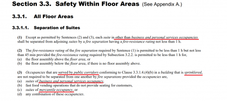

Ontario building Code section 3.3 deals with safety within floor areas. When the conditions in 3.3.1.1. are not satisficed, such as in a building with business and personal services or mercantile as major occupancy that is not sprinklered, how to determine the fire resistance rating of the separation of suites?
The reason I am asking this question is that unlike other major occupancies, there is no subsection in section 3.3 which dedicatedly deals with safety in business and personal services or mercantile occupancy.
They are exempt from the fire resistance rating. However, the separation must still be constructed as a fire separation. Most people call this a "smoke seal" the intent is just to prevent the circulation of smoke between suites, but not provide an hourly rating against fire.
To put this in context: I had news today of a person who owns a part 9 building - two storeys. D occupancy on the ground floor, C suite (one) above. They want to create a second D occupancy on the second floor. We will require a 45-minute fire sep and STC 50 between the new D and the C, but 9.10.9.13(1) exempts D occupancies from a rated fire separation: so a fire separation is required (ie: drywalled demising wall) but no rating is required. Were the building sprinklered, the fire separation would not be required. [9.10.9.13(2)].
