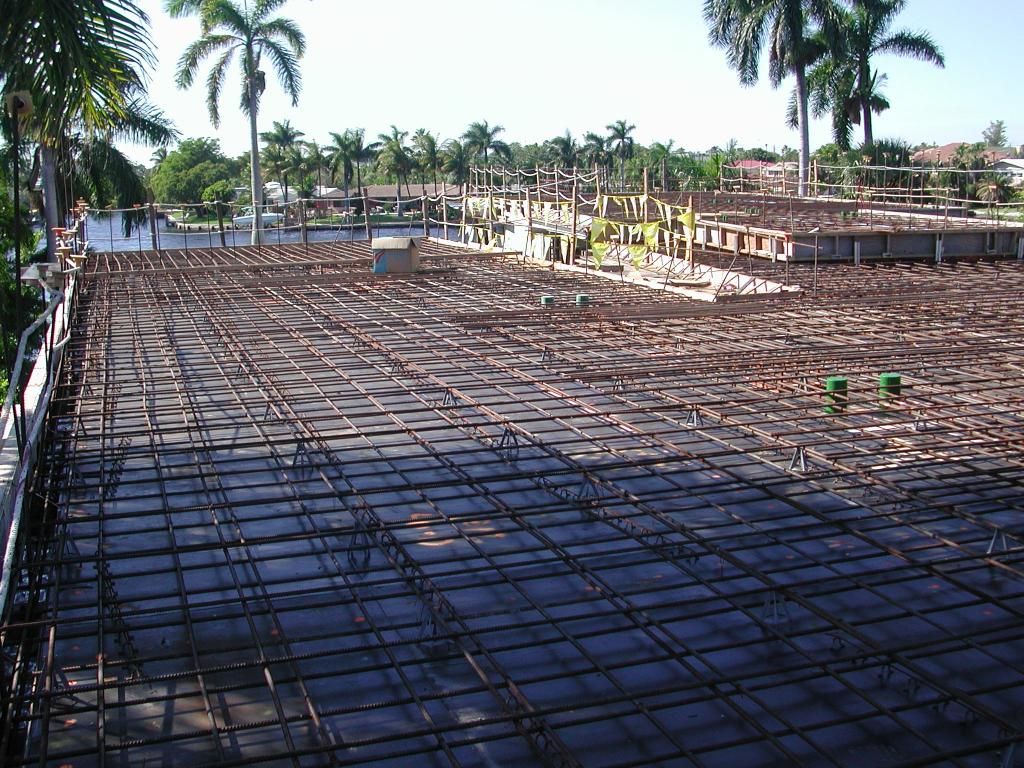

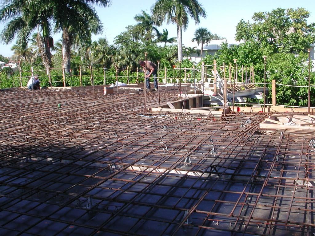

Here are some pics from the job I was on today. This is a SFH (more like a bomb shelter). Is there enough steel in this?

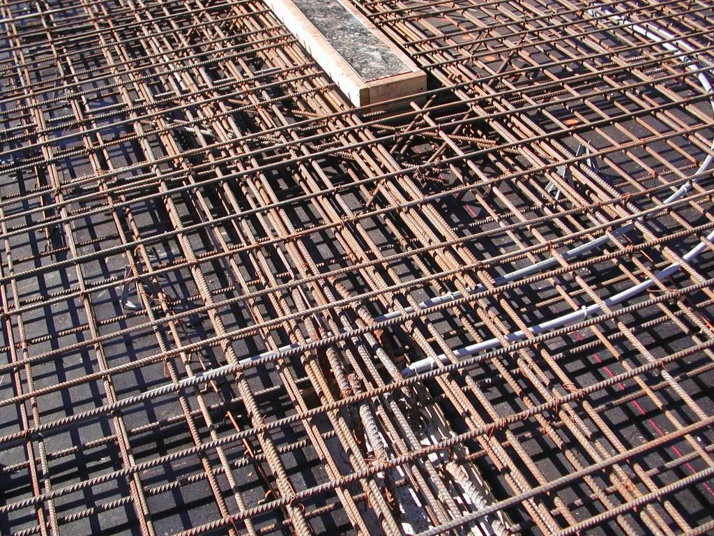

How about this, enough steel around this column?

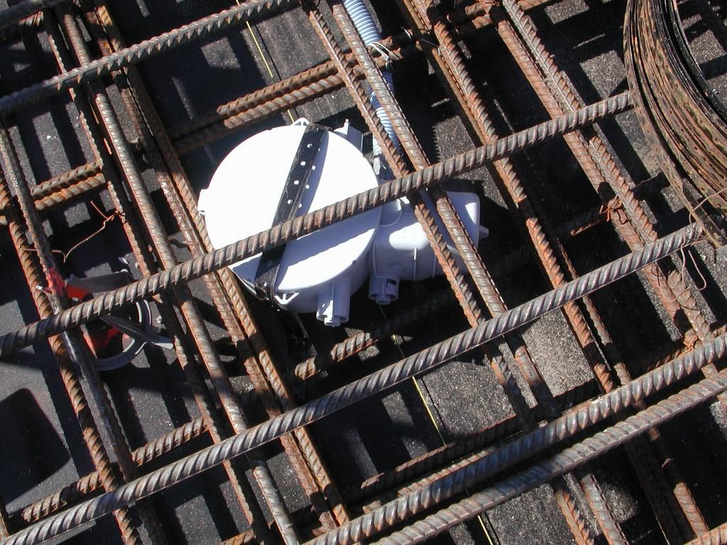

And here is the recessed lighting we were installing. Luminaires from Belgium. We took ¾ ENT (smurf tube) with us and it wouldn't fit into the snap in connectors you see at the bottom of the luminaire. My guess is that the connectors are for 20mm corrugated conduit. We heated the connectors slightly with a heat gun and we were able to snap in the ENT. Dennis, if you read this, yes I am familiar with 410.6.
Dennis can read? :razz:
I can read when I want to but I"d rather bust them whenever I can. The first thing I thought of was 110.3 but I actually decided against it-- I was having a weak moment. :D
410.6 Listing Required.
All luminaires and lampholders shall be listed.
And if the inspector notices...after the pour? A big fat CE on the box won't get you far in Florida.
