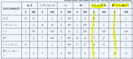

Yeah...I keep leaning towards S1..we have already kind of established they are a "higher hazard" per the incidental stuff If you go U, you would still have to separate the U basement or upper story mech room in a NFPA13 building (or go non-sep), with S1 you don't...
I know that is very one dimensional, but it's a start....I think the U is more limiting for stories and area too...
It is a 2 story E occupancy so it will be sprinklered so no separation are required between an E and a U occupancy
Correct, but the IIB E is allowed to be 43500 Sprinklered Multistory and the U is only 25500......The S1 is 52500.....Don't hold me to any of those numbers....
Circling back on this. Its looking like we are going to classify the basement as F-2 IBC / Industrial NFPA. Both allow for one exit from the basement and will not have any real impact on allowable building area going non-separated mixed use.
