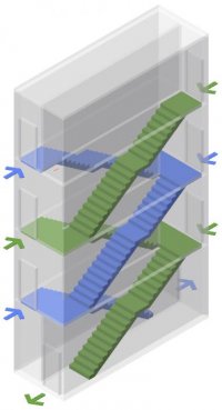

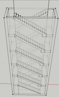

scissor stairs - fills requirement for 2 means of egress.png Scissor Stairs.jpg
This was an interesting question. Google had many examples. Both of these were used in comments stating they meet the code separation.
Fire-rated separation is not clear from the original posters question (or in these examples), But in order for them to meet the code requirements there needs to be a fire-resistance rated separation between them.
View attachment 2724 View attachment 2725

Scissors stairs used to be common in some cities. They are supposed to be separated by a noncombustible wall. The reason they were banned (actually I think they were no longer allowed to be considered as 2 separate exits, but I can't find where that is hidden) is because it was almost impossible to seal the dividing wall adequately to prevent passage of smoke from one stair to the other.

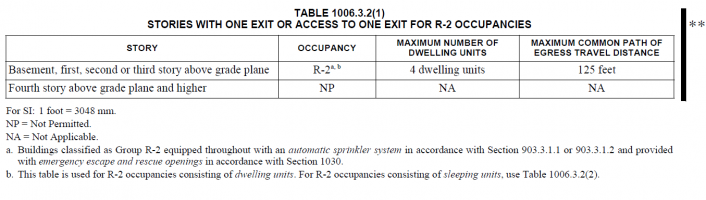

Yes, I think the section is quite clear, it is considered to be one exit. The plan exceeds 4 units, so a 2nd exit is required that meets the separation requirements.
