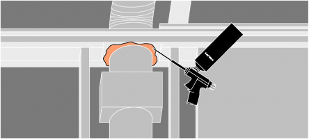

What are you accepting in the way of sealing up penetrations through fire blocking?
In particular, for commercial wood-frame buildings (Type V-B or other) where you have pipes and wires that penetrate your sole or top plate of the wall, how do you seal around the penetrating item? As an example, think of an interior load bearing wall in an apartment building. Wiring or plumbing comes from under the slab, runs up through the wall, then either continues into a wall above, or runs horizontally through the floor. No penetration through GWB (thus no through or membrane penertation) has been made, therefore no fire-stopping. Only the plate, which serves as fire-blocking, has been penetrated.
For us, the fire-foam is a no go. It will fly in residential (not preferred) as the can has a listing on it approving it for residential use; but for said reason, we do not accept it in commercial buildings (apartments, hotels/motels, office buildings, etc.).
Fire-stopping (fire-caulk or other) is only required for membrane or through penetrations of a rated assembly. A pipe or wire traveling vertically may not penetrate through the sheetrock and does not therefore meet the intent of a membrane or through penetration. Per IBC Section 714.1, said section, which stipulates the use of fire-stopping, does not pertain to non-rated walls.
714.1 seems to indicate all of 714 is out of context if not penetrating a horizontal assembly or a fire-resistance-rated wall assembly; however, 714.5 speaks of penetrating nonfire-resistance rated floor or floor/ceiling assemblies.
718.2 really does not provide much other than saying that the integrity of fireblocks must be maintained.
