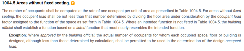

I applied IBC 1104.4: 1726440799009.png
with the reasoning that it's storage. There isn't going to be more than 5 people up there if the code official allows per this exception:
Putting the elevator in now would make the most sense, even if it's storage, maybe even because it's storage. I think I am stuck in a circle of overthinking and overanalysing. I keep looking to find the answer they want and can't find it so it must mean it's not there, but I am not an expert.
I am familiar with that exception. In order to use it, the building official has to agree to it. Otherwise, the occupant load of your 6,100 s.f. space is 13 people if the space is storage (warehouse), or 41 occupants if it's sued for offices. You would be (IMHO) exceedingly foolish to proceed on the assumption that the building official will approve your arbitrary occupant load of 5 people in 6,100 s.f. I know I wouldn't approve it. (Not that I could -- I'm an ABO, so it would be up to my boss -- and I don't think he would approve it, either.)
Have you asked the AHJ if he/she will accept your 5 person occupant load? What's your justification for that number? It strikes me that the only "justification" is that if you keep it to five or fewer, you don't need an elevator. That's not much of a justification. We have had applicant try that game with respect to other features that they didn't want to pay for so they requested arbitrary occupant loads far below the minimum called for by Table 1004.5. The boss didn't buy it.
The building official where this project will be constructed might accept it. I don't know. But if you are (or work for) the architect, be advised that now is the time to ask the question, not after the design has been locked in and the working drawings have been completed.
