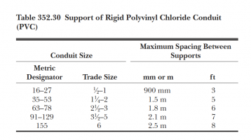

All PVC conduit must be securely fastened within 3' of each outlet box, junction box, device box, conduit body or other conduit termination.
If you had PVC conduit run horizontally along a wall, how often would you have to provide supports such as listed conduit straps?
Every 3 ft horizontally. If it goes through studs, is that considered support? Does it need to be fastened to the studs?
Three feet is the max distance between supports, for small conduit. Larger conduit can be spaced farther apart. If an electrician goes b6 the rule of thumb of 3 ft, it will meet or exceed code. Wait ... no point in exceeding code, right? So better off to read the chart and do the minimum necessary.
