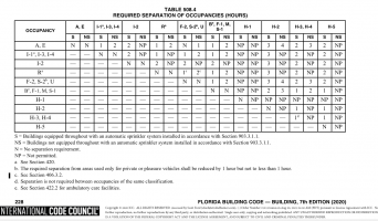

We are currently in the process of preparing permit documents for a new metal building intended for business use, non-sprinklered. The building will serve as a work office (primary purpose) for a General Contractor. The front 1/3rd of the facility will be dedicated to open office space, while the remaining area will be used for general storage. The Florida Building Code, specifically Table 508.4, states that there should be no separation required between Business and S1 or S2 Storage. However, according to NFPA Table 6.1.14.4.1(b), it is necessary to have a 2-hour separation between the two spaces. Before presenting this situation to our local building officials, I would like to receive input from the community on this matter. The floor plan is attached for reference.

Based on my understanding, the code that is the most restrictive should be chosen.
Florida must have changed the table, because IBC 2021 calls for a 1-hour separation between B and S-2 in a sprinklered building, and 2-hours if unsprinklered.
Yes, it would appear that you are interpreting it incorrectly. Start with F-2, S-2 and U on the left column. Read across to the columns under B, F-1, M and S-1. What I see is 1-hour under S (sprinklered) and 2-hour under NS (non-sprinklered).
B to S-1 has no rating required.

Keep in mind that those separations apply only if you declare the different uses as separated. You have the option of treating the entire building as non-separated mixed uses. (IBC 508.3)
It's almost always S1....
I agree. Paradoxically, in the case of B to S-2, the B is the higher [fire] hazard occupancy, so you're actually protecting the S-2 from the B rather than protecting the B from the S-2. But a 3,200 s.f. building should be small enough to be treated as non-separated mixed uses, in which case any questions disappear.
508.2 Accessory occupancies. Accessory occupancies are those occupancies that are ancillary to the main occupancy of the building or portion thereof. Accessory occupancies shall comply with the provisions of Sections 508.2.1 through 508.2.4.
508.2.1 Occupancy classification. Accessory occupancies shall be individually classified in accordance with Section 302.1. The requirements of this code shall apply to each portion of the building based on the occupancy classification of that space.
311.1 Storage Group S. Storage Group S occupancy includes, among others, the use of a building or structure, or a portion thereof, for storage that is not classified as a hazardous occupancy.
311.1.1 Accessory storage spaces. A room or space used for storage purposes that is accessory to another occupancy shall be classified as part of that occupancy.
