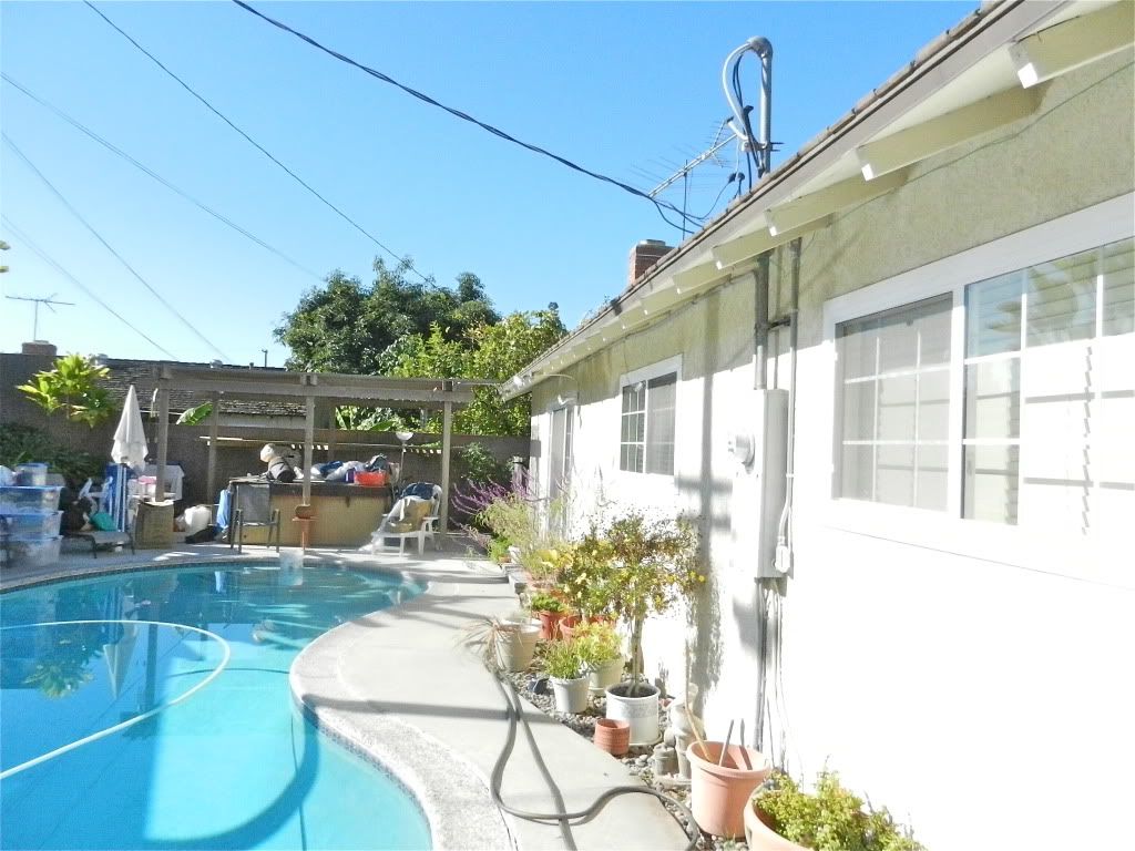

Antenna wire saves the day.
That is a residential service that crosses over a bootlegged room addition. I was several houses away from this so I don't know what, besides the antenna wire, might secure the lumber.
in california the poco has jurisdiction to the meter per the department housing and community developement. If i see something like this i get on the horn to the poco.

Were I inclined to do anything about the service drop, this is what I would use:
230.1 Scope.
This article covers service conductors and equipment for control and protection of services and their installation requirements.
230.24 Clearances.
Service-drop conductors shall not be readily accessible and shall comply with 230.24(A) through (D) for services not over 600 volts, nominal.
(A) Above Roofs. Conductors shall have a vertical clearance of not less than 2.5 m (8 ft) above the roof surface. The vertical clearance above the roof level shall be maintained for a distance of not less than 900 mm (3 ft) in all directions from the edge of the roof.

This is a triplex service drop and it's what the poco provides today.
Mac said:
Check 680.8 "Overhead Conductor Clearances" - Which came first, the servcie or the pool?
I don't know. The drop was 10' above the water. The CA Public Utilities Commission has decided that we will follow Edison's rules for service drops over pools and the clearance for triplex drops is 12'.
I found this one because of a kitchen remodel. I was checking to see if the two breakers for a multi-wire branch circuit feeding a single receptacle were handle tied. They weren't tied and I had Edison raise the drop. The service panel is 4'9" from the pool but there's not a lot that I can do about that.
I haven't checked the records to see if the el. panel was permitted. If it was permitted, then an inspector blew it. The owner mentioned that it was inspected and Edison made the previous connection. All's well that ends well.
UPDATE: The pool has no permits.
Edison's rules for service drops over pools? Less restrictive?
If following the NEC, would this SD have to be 22.5 ft above the pool?

Yes it would.
