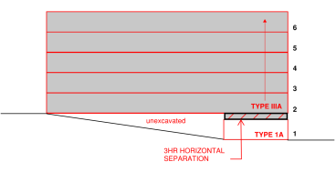

What considerations (cost, ease of construction, future maintenance, penetrations, etc) do you make when choosing between a UL fire-rated horizontal assembly that is either a floor-ceiling assembly or a directly applied protection method? For instance construction type 1A protected steel podium construction (3HR), group R-2 with some amenity spaces.

Yes, were are doing 5 stories of IIIA over 1A. Using horizontal building separation allowance per 2018 510.2.

Thanks, but no parking garage. I guess I'll explain the building. We have 6 stories total. The site slopes substantially so on the low elevation is our 1A, at the high side it's basically slab on grade at that point and that is floor 2. Floors 2-6 are IIIB (sorry I said IIIA earlier). III over A is needed because we need 6 floors to meet the developers unit count.
Here is a bad diagram explaining. I'm just curious what the practical and technical considerations are if we spray the steel structure with SFRM or use a floor-ceiling assembly. We will have HSS columns below the podium, and columns along the exterior will probably need to be hidden in the exterior wall.

Assemblies like UL D739 look reasonable for 3-hour. Not extremely thick on the concrete. Spray it all with fireproofing. UL D916 makes sense, too. Thicker concrete. Unprotected deck. But I’d wonder about wasting height. Bar joists would allow you to thread ductwork and sprinkler pipe through the structure. So if you can work out the penetrations, I’d probably look pretty hard at something like UL G529 or G512.
