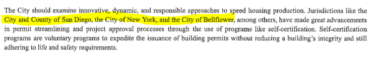

I read "San Diego Assemblymember Chris Ward introduced a state bill that would give small building project developers the ability to hire a third-party licensed architect or engineer to sign off on a project’s plans if a city’s planning department is too slow." so don't know if they are being more permissive.
In case you missed the link, I'm posting the entirely of the text, which answers some of the questions raised in this thread:

That original version of that order further directed the Department of Building and Safety(LADBS) to report back on what permit review(s) could potentially be replaced by a self certification procedure by a licensed architect to expedite the reconstruction of single family residential structures damaged or destroyed by the Wildfires of January, 2025.
Establishing a self-certification program can be an important tool to rebuild neighborhoods quickly and safely, and allow impacted Angelenos to get back home. Several cities ,including New York, Chicago, Phoenix, Dallas, San Diego, Bellflower, Oxnard, and the County of San Diego have implemented self-certification programs proven to reduce permitting timelines.
LADBS currently has an express permit program in which certain smaller-scope permit types can be obtained online without plan check review. A self-certification process would allow a licensed architect in the State of California to assume responsibility to verify compliance with all or some of the building and zoning codes applicable to construction projects on private property in the City of Los Angeles. Self-certified plans would not be reviewed and approved by LADBS and the necessary permit(s) would be issued relying on the self-certification by the licensed architect, eliminating the need for a plan check process via LADBS.
