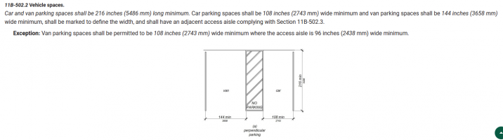

Car parking spaces shall be 15 feet in width including 5 feet of cross hatch. Van parking spaces shall be 16 feet in width including 8 feet of cross hatch.
So does this verbiage mean that I can't use three 8' parking spots, make the middle one an access aisle, and have a van accessible on one side and a regular accessible spot on the other side?

Either one, I can take three 8' spaces and put an access aisle in the middle, a van on one side and a regular ada compliant on the other. Correct? Just not with the original post requirements.
Correct. Things are a bit more difficult when dealing with a single stall, but generally the idea of striping off the middle of three 8' stalls would work.
The language provided in the OP is unnecessarily challenging and the intent is lost via overspecification of the stall width. Providing flexibility via coupling the stall and aisle width makes more sense from a practical standpoint and allows for the greatest ability of meeting the intent of the code.
  1. Van parking space must be 132 inches wide minimum with an adjacent 60-inch wide minimum access aisle. A van parking space of 96 inches wide minimum width an adjacent 96-inch wide minimum access aisle is also permitted (see below).

If we assume that (a) "including 5 feet of cross hatch" means exactly 5 feet and (b) the cross hatch areas of parking spaces may overlap as a shared access aisle, but the rest of each spot may not overlap, then the above text requires 10 feet clear for the car, 8 feet of common cross hatch, and 8 feet clear for the van, so at least 26'.
Which makes me wonder, given the other sources cited, if the '15 feet' quoted isn't a typo, with '13 feet' intended.
