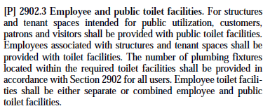

1. Are new small apartment buildings (R2) that only have one or two small hallways need to have an employee toilet room for the employee that cleans them and cuts the grass need an employee toilet room?

IMHO, No.
Are the cleaner and the lawn care service employees, or contractors?
IBC Table 2902.1 does not require toilet facilities for staff. However, the Commentary to IBC 2902.3 suggests that a toilet room is required if they are employees.
I could understand that a toilet room can be required for a large apartment building with many faculties like swimming pools. exercise rooms, large lobbies, etc. but the code does not seem to give a break for small apartment buildings that only have hallways or not and outdoor areas to maintain.
I am inspecting a 10-unit 2 story apartment house now that put in a non-accessible employee toilet room in the janitors closet that was not on the plans, so the maintenance person has someplace to go. It would need a lot of changes to make it accessible and I want to know if they could just eliminate it.
They don't know if they will have an employee do the maintenance or hire a service or just make a deal with one of the tenants to do it at this time. The definition of an employee is very mystifying. IBC does not have a definition and if you google what the legal definition of an employee you get some very complicated answers.
Another problem is that the code does not say if a employee needs to be a employee of the owner of the building. A pizza delivery person is a employee but not an employee of the building owner. I am an employee too which would mean there should be a toilet room for me everywhere I go.
I would say that if it is an offsite vendor or employee providing maintenance/gardening service, then they are not "associated with" the structure, they are associated with their offsite office structure, and they are not required to have a toilet onsite.
