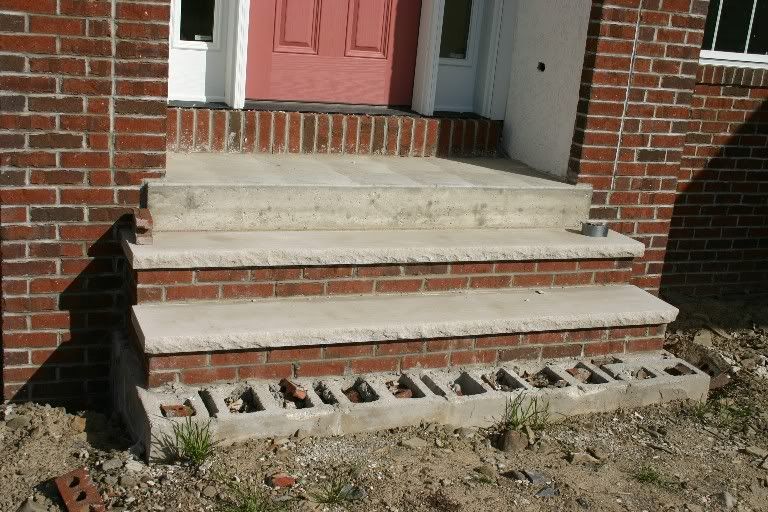

So wrong on multiple levels. Steps, landings, sidewalks, elevations and more
13,279
When you deviate from approved plans. How do you fix this and how is is possible to fix the rise issue on the bottom step now that there is block there?

I wholeheartedly agree that this mess should be ripped out and just
start over, however, in some political climates, that isn't an option.
It isn't about doing what's right, ...it's about keeping the elected
officials in office and keeping the "fires" / telephones from ringing
off the hook.
Building a new, compliant deck around this mess might be a good option.
Just do not anchor the deck to any of the brick veneer.
Good Lord, how deep is that "landing", 24"? It doesn't appear to be 36" deep. Is this a front door? I've never seen a deck built on the front of a house, so I don't know if that would be an option. But there's a first time for everything. It appears they could add more block around the perimeter to extend the porch, fill that in, pour a slab up to the one that is there, and brick veneer the perimeter to finish it out. Add a nice wrought iron guard rail and handrail and you're good to go. Whatever they do, it will cost money to fix.

Unfortunately, that is exactly how it works in most jurisdictions.

The easy fix to make it right, forget the little bit of savings is to figure for extending out the landing to 42", then add the stair layout this gives you your correct foot print for the correct footing.
Now dig and pour the correct size footing, add Hilti type boltings to connect the pours and build the correct landing and stairs. If done right they can even lanscape to not have to add guards or handrails, but they would add to the entrys look.
Seems this mason travels around, get a look at this one.
The thing here is the Mason was explaing to me, that you can't build 7.5" risers on this 30" rise, they don't make bricks for that, I kindly asked do you own a stone saw?:ugeek:
