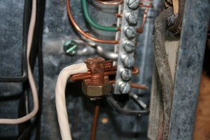

Ok. Not being an electrician i didn't know specific connectors existed.
BB ... if you zoom in you can see UL cast/stamped in the side of the bolt. So i assume you mean the correct size? And it look like there are multiple conductors in there. Looks like a hack job.

A homeowner did it. I asked him to move the spit-bolts to the ends of the armor.
You asked him to do that because...............why?

The other end of the armor terminates at a service cabinet. The armor stops at the point where it is clamped. The armor is not allowed to enter the cabinet. The explanation that I was given is that the current will make it to the end of the armor no matter what so that’s where it stops and the bonding bushing takes over.
If that’s true at the service cabinet I reckon it’s also true at the rod.

So the fact that split bolts are not listed or labeled for use on the armor is OK? and to tell him to redo what is already not in the code is OK? I would love to see the justification for this other than a phone conversation, especially for a GEC system and products already tested and listed under UL467. Why not just tell him the unnecessary split bolts are in violation of 110.3(B) and to just remove them and the extra clamp, save money and pass the inspection? But you'd rather show how smart you are by telling to to change the location of the split bolts to another location they are in violation?
250.62(E)(1) General. Ferrous metal raceways and enclosures for grounding electrode conductors shall be electrically continuous from the point of attachment to cabinets or equipment to the grounding electrode and shall be securely fastened to the ground clamp or fitting. Ferrous metal raceways and enclosures shall be bonded at each end of the raceway or enclosure to the grounding electrode.
