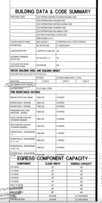

Hello, I'm struggling to grasp the sprinkler requirements for construction type '5B(Non-sprinklered, no fire alarm)', as the building, about 7000 sq ft in size, previously designated as A2 (The building has been only operated as a restaurant ever since they built.), remains unchanged in use group. I received the comment and the reviewer asked me demonstrating non-requirement as per VCC (Virginia Construction Code) 2018, section 903.2. as 'show how the fire sprinklers are not required per VCC (Virginia Construction Code) 2018, section 903.2.'"
The building, initially designed for a restaurant and renovated to 2012 VCC Level 2 standards, faced no sprinkler requirement issues. Presently, I'm working with a "New Tenant Fit Out" and Level 2 alterations under the 2018 VCC, I seek clarification on why fire sprinklers may not be mandated as per section 903.2. Your thorough insight into this matter would be invaluable.
Attached are screenshots of the building information for your reference, noting no alterations in use group or structural elements.
Can you confirm I’m understanding you correctly:
Original and existing construction type: 5B.
Original and existing area: 7307 s.f. (interior and exterior dining, per your code summary.)
Original occupancy classification: Assembly Group A-2.
New tenant occupancy classification: Assembly Group A-2.
Does the General Note 6 referenced in your code summary have anything that might affect this?
I appreciate your prompt response and yes, you are correct about the information you provided. This note was left by the previous tenant, and I believe it adequately addresses my concern. Could you please confirm if my understanding of the sprinkler requirement is accurate?
You’re welcome, thank you for the attachment showing General Note 6.

As both an architect and as a plan reviewer, I would not accept your note #5. You cannot "assume" that something complied with the code at the time it was built. We currently have a remediation in planning because of a condition that didn't meet the BOCA code under which it was constructed in 1986. There's nobody left in either the Building Department or the Fire Marshal's office who can explain how it was allowed, but everyone (including the State Fire Marshal) agrees that it doesn't comply now, it didn't comply when it was constructed in 1986, and therefore it has to be corrected.
We have had other projects where the submitted drawings assumed fire resistance ratings of corridors and stair enclosures. When we asked for verification, whaddaya know? They weren't what the architect had assumed. Much fun ensued.
If you are the architect for the current project, it is your responsibility to verify any conditions that you assume met a previous code.
Note 4 also makes the assumption that the existing building met the accessibility requirements at the time it was constructed, so that’s two points that could lead to some “fun” down the road!

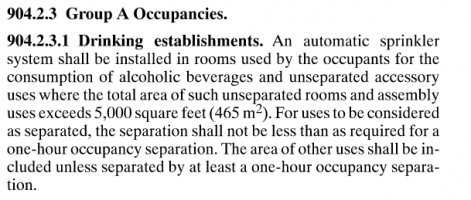

Below is when the UBC required sprinklers in an "A" occupancy. As you can see an occupant load was not a factor like it is in the I-Codes
Interesting that occupant load wasn’t a factor. If 5000 s.f. was the limit and if I were to assume a kind of worst case 75% of that was for standing space per Table 1004.5 that is 5000 x 0.75 = 3750 s.f./5 = 750 occupants, so it looks like the current requirement is probably more conservative. But I think that’s generally the way changes in the codes work, no?

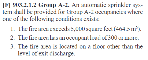

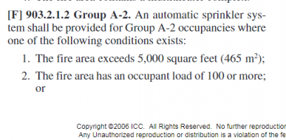

2000 was the first time the OL was a factor in the requirement. 2006 IBC dropped the OL from 300 to 100 fire area.
2000 IBC
2006 IBC
I bet people complained about such a big reduction in the occupant load. Firm where I was working at that time wasn’t doing any projects with assembly occupancies for me to have noticed the reduction.
