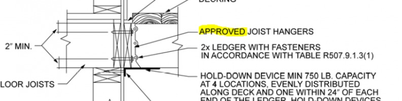

We have an issue where elevated beach walkovers are subject to hot, humid, salty sea air 24/7/365 and an occasional storm surge with spraying salt water. What this means is that historically, those that used galvanized bolts, washers, nuts, connectors, and joist hangars have experienced a very, very short life span. Basically, hot-dipped galvanized products simply don't work well at all in this application. Stainless steel is the way to go. However, I can't find any code requirements that would specify stainless over galvanized.
Is there a section of the code I am missing, or are there any pending changes that address issues like this?

Reach out to simpson strongtie in your area....they will tell you how to get there....Probably installation instructions... or remember that all hangers have to be "approved", so approve whatever you want...

R104.9 Approved materials and equipment.
Materials, equipment and devices approved by the building official shall be constructed and installed in accordance with such approval.
If a building official can decide to approve a material the building official can decide to not approve a material. If that is not true then why bother stating that materials and equipment shall be installed per the the building official's approval.
R104.11.1 Tests
This section empowers the building official to require a test to determine if a material meets the intent of the code. Granted it is for an alternate material etc. but it establishes a scenario where a test is used to convince a building official that the material should be approved.
You have a real world test where the material failed and therefor does not meet the intent of the code. Just say no and see what happens.
