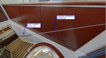

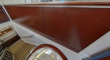

We are in the planning stage of a minor reno of a bank brach, and i have a question about the stair handrail. Old building, back to the 1960’s i think. Two floors, they installed a lift a year ago. As shown in the pictures, there's a continuous handrail down one side of the stairs, and a discontinuous rail on the other side. We’re planning to make both continuous.
That’s a large mirror on the wall, makes the narrow branch look much wider. And the hemisphere at the bottom of the picture is the mirror dome for a 360 camera we use for surveys. Very slick.
Here’s the question. The side wall of the stairs steps back at the floor line (that’s the demising wall to the next tenant) so if we continue the rail in a straight line the gap widens. I don’t have a measurement. Would that be acceptable, or should we fill in the space?

Either way will probably work well enough. A straight line is what I would expect to find. The offset appears to be substantial and if there were an accident an offset hand rail might be blamed.

Ice ... the handrail extension at the top would be a straight line from the existing rail. Like you played Hulk and stretched it to the top. Was not proposing an offset in the rail where the wall steps back. So that’s what’s driving the question: the resultant increase in offset from the wall. Will that cause a problem?

It would not for me. I don't see a hazard and I don't see a detriment to the intended use of the handrail.
The typical is to run straight and install on posts down to the treads and at the upper landing floor level, extend the minimum extension and then turn down and terminate into the floor.
The stringer then forms the visual line. And since you are not mounting to the wall at that point, because it is set back, it becomes a free-standing handrail, no different than an intermediate handrail down the center of a wide stair flight.
