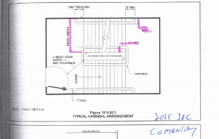

2018 commentary shows it measured beyond the 4.5" max. projection. You can also see that other things below the handrail can project into this space as well.1677086527126.png
The only places I know of where width has to be measured between handrails are accessible stairs (IBC 1009.3.2) and intermediate handrails on wide stairs (1014.9).
