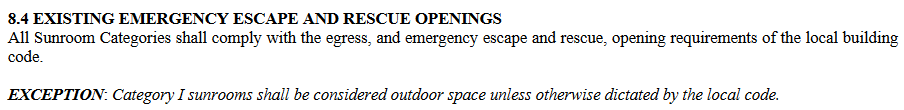

https://www.nationalsunroom.org/AAMA-NSA-2100-19.pdf
I think I may have found the answer to my query if anyone is interested.
In R301.2.1.1.1 Sunrooms. Sunrooms shall comply with AAMA/NPEA/NSA 2100.
The following seems to be the only pertinent section:
I assume that this means Categories II thru V are considered indoor space. Therefore, no landing is necessary.
