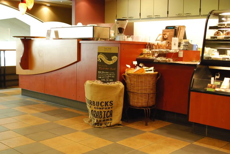

pickup counters TO THE LEFT
order counter TO THE RIGHT
Does the height of the order counter meet ADA requirements? If so, why couldn't they just serve those with disabilities at that counter?
The height of the "order counter" was not the issue, you need to provide the "same" service not special service to all.
the barista does not know it is a disabled person getting the order. He/She just calls out the name on the cup.
But note all that "stuff" on the counter and in front of the counter, that is a violation of the clear space requirements..... clear space does include "stuff"

the pickup counter isn't an issue (or wasn't at final) at those that I've inspected.. the "stuff" can all be moved.
This movable stuff creates problem! The existing payment counter is obstructed. Are we responsible for inspections for ever?
The pick-up counter never was in compliance.
RJJ said:
This movable stuff creates problem! The existing payment counter is obstructed. Are we responsible for inspections for ever?The pick-up counter never was in compliance.
Are you responsible if someone blocks an exit door?
It is a code violation.
In PA they hold us up with L&I inspection on ADA issues. Every few years they conduct a witch hut.
To answer your ? no we are not held responsible for other code violations.
If they won't move the stuff, it becomes a civil rights lawsuit which isn't our problem.
