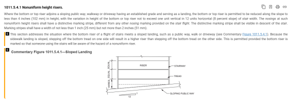

What is the building code which deals with such a stair construction. The picture of a stairway adjoining a sloping pathway as displayed by the link.

From the 2012 IBC;
1009.7.4 Dimensional uniformity.
Stair treads and risers shall be of uniform size and shape. The tolerance between the largest and smallest riser height or between the largest and smallest tread depth shall not exceed 3/8 inch (9.5 mm) in any flight of stairs. The greatest winder tread depth at the walkline within any flight of stairs shall not exceed the smallest by more than 3/8 inch (9.5 mm).
Exceptions: 1. Nonuniform riser dimensions of aisle stairs complying with Section 1028.11.2.2. Consistently shaped winders, complying with Section 1009.7, differing from rectangular treads in the same stairway flight.
Where the bottom or top riser adjoins a sloping public way, walkway or driveway having an established grade and serving as a landing, the bottom or top riser is permitted to be reduced along the slope to less than 4 inches (102 mm) in height, with the variation in height of the bottom or top riser not to exceed one unit vertical in 12 units horizontal (8-percent slope) of stairway width. The nosings or leading edges of treads at such nonuniform height risers shall have a distinctive marking stripe, different from any other nosing marking provided on the stair flight. The distinctive marking stripe shall be visible in descent of the stair and shall have a slip-resistant surface. Marking stripes shall have a width of at least 1 inch (25 mm) but not more than 2 inches (51 mm).
Interesting note, it states you must be a minimum of 4 inches in height, no more than a 1:12 slope, but nowhere does it give a maximum riser height if you are using this exception...... If my stairway is eight feet wide, does this mean that the minimum riser would be 4 inches one side and 12 inches on the other end? of the bottom riser.
Common sense would dictate a maximum riser of 7 inches as outlined in 1009.7.2.
I'm reading it as this section allows you to reduce to less than four inches, as an exception to the riser heights called out in 1009.7.2.
No
1/12 slope 8 ft long would run into the second riser on the stairs with a maximum 7" rise per code
