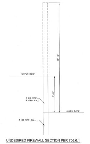

Can a stepped building fire wall terminate 30 inches above the upper roof per 706.6 instead of complying with section 706.6.1?
My scenario has an approximate 4 - 5 foot difference in roof heights.
Thanks in advance.

Expanding on BB need to use 706.6.1 stepped building provisions with different roof heights.
Note provisions have been added to address firewalls adjacent to sloped roofs in the 2012 edition.
IMO it is a stepped bldg. so has to meet 706.6.1 and can stop @ 30in. if it meets the requirements of 706.6.1 or the exception.
Thanks for the answers, but I did not convey things properly.
This is what I want to do . . . terminate the fire wall 30 inches above the upper roof and have nothing above it. The more I think about it, the more I believe this is acceptable. In my mind, it is no worse than having adjacent roofs at the same elevation.
I don't suppose I could do the following (without the dashed wall portion.) There is nothing above the higher roof and adding another 10 feet of one hour rated wall to meet the conditions of 706.6.1 Stepped buildings does not seem logical to me.
The exceptions under 706.6.1 are not desirable - fire rating around 15,000 sf of ceiling and structural steel.
I believe you can do that as long as the lower roof has the one-hour FR for the entire length of the portion with out the parapet. But i bet someone besides me will chime in soon.
If you use the stepped building method and stop the fire wall at the lower roof, then, as my250r11 stated, the exception to Section 706.6.1 will apply. The 1-hour extension need only extend up to 15 feet, but if the wall is not 15 feet high, then the entire wall above the lower roof will need to be rated 1-hour with protected openings.
If not using the stepped building exception of Section 706.6, then the fire wall will need to extend up to 30 inches above the upper roof, unless one of the other exceptions of Section 706.6 permits it to stop at the deck of the upper roof.
Thanks Ron,
Your response regarding the one hour rated wall for a stepped building is clearer to me than the code section.
BTW, I edited the first picture. It is humongous now, but it shows the condition in its entirety.
