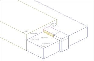

I have an existing aircraft hangar built per NFPA 409 Standard on Aircraft Hangars.
This is equivalent to a II-B construction type but its columns are protected by column sprinklers.
Now, there is a separated part of the building as an operations support.
It has a 1hr FR separation from the main hangar area and the slab is also 1 hr FR, while the wall above the slab is not rated.
The new owner is planning an assembly occupancy addition over the support part of the building as per attached rough sketch. Its use will be staff recreation area but they intend to hold celebrations and such on occasion.
The wall separating the addition from the hangar wall will be 1 hr FR.
What would the requirement for the glass facade and the addition roof be?Small hangar.jpg
Is there a code section for the hangar separation?
Yes there is a section in NFPA 409 edition 2016 for the specific Group (This is a Group I hangar):
5.2.4 Where a storage and servicing area has an attached, adjoining, or contiguous structure, such as a lean-to, shop, office, or parts storage area, the wall common to both areas shall have at least a 1-hour fire resistance rating, with openings protected by listed fire doors having a minimum fire resistance rating of 45 minutes and actuated from both sides of the wall.
