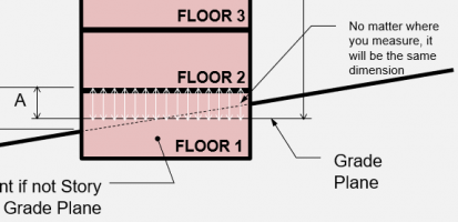

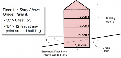

To explain visually here's a diagram that I use in my presentations and in my book:
A little off topic, but just a note. As always Ron's graphic is spot on. The point that is often overlooked is the B dimension with underground parking. The problem that sometimes occurs is that the elevation of the ramp at the face of the building exceeds 12' and technically makes the underground parking the first story, always be sure to check the ramp. Just a random thought.

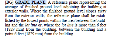

Note that the definition refers to grade plane and not finished grade. The grade plane will always be parallel with the floor, so you cannot have a story that is only 50% above the grade plane. Refer to the definition of grade plane in Chapter 2 to see how to determine the grade plane for your building. If you have a sloping site, then the grade plane may be above the finished grade on one side of your building and below the finished grade on the other side of your building--just like my diagram shows.
A story is considered either a story above grade plane or basement--there is no in-between.

Maybe provide a sketch of your situation, because I don’t understand how a floor can be partially (i.e., 50%) above the grade plane—if one part is 6 feet above, then the entire floor must be 6 feet above.
My sketch would look just like your graphic, except that if I take the section in one part of the site, the "A" dimension is less than 6', while in another part of the site, the "A" dimension would be greater than 6' (the topography of the site). This is where I believe the 50% comes in under the definition....if the grade plane around 50% of the perimeter (where the sections are taken) is greater then 6', it is a story above grade plane. If less then 6', it is a basement. This takes the topography into account.
There is no 50% in the definition—I have no idea where that is coming from. The grade plane is the grade plane...it is set at one elevation. Topography only factors in when determining the grade plane. Once the grade plane elevation is determined, the floor next above is either at 6 feet or above, or it’s below 6 feet. No matter where you measure the distance between the floor and the grade plane, it will always be the same.
Having a simple mind and being lazy, I typically will take "spot" elevations around the building (or 6' off), add them up and divide by the number of elevations took, this should give you the "Grade plane". Note, as Ron mentioned, this will give you one constant elevation.
Ken
khsmith...yes, that's what I was seeking...the perimeter spot elevations need to be taken around the building, then averaging them to determine the A dimension. O.K. I feel better. Ron thanks for hanging in there with me. I do use your book but is at the office which is presently closed due to the virus. I am attaching a screenshot from the online 2019 cbc showing the 50% I was referencing to (at the bottom of definition of story)
...my screenshot didn't catch all of the definition. Anyway, I don't know where the 50% applies. Thanks for the help.
