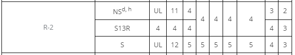

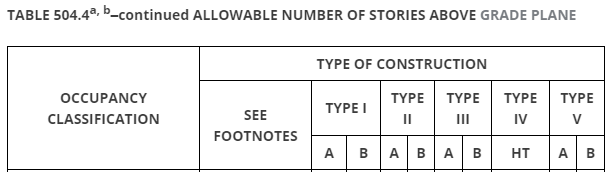

Hello, I'm doing the feasibility study for a new residential building in Miami Beach. It's a small building, for apartments with a total of 7,500sf. The maximum number of stories by the zoning code is 5 levels.
I'm placing parking spaces on the ground floor + 4 residential floors, so, 5 floors in total.
Reading the Section 1006: Number of Exits and Exit Access Doorways in the building code, table 1006.3.2(1), I noticed that I need at least 2 exits for R-2 buildings with more than 4 stories.
Is that possible? The building is very small and have only 4 apartments, if I place two exists stairs it would make the efficiency drops a lot...
