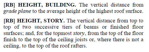

2021 IRC:
I can see two conflicting arguments. If the height of a building is measured to the mid-point of the highest roof, why wouldn't the same apply to your cathedral ceilinged story? But the definition of "story" makes no mention of mid-point, or average height. The story height, by definition, is measured to the top, which would be the peak. By this analysis, your story is 22 feet high.
Unfortunately, even the IRC Commentary fails to take into account cathedral ceilings. I think if I were reviewing the plans, I would extrapolate from the definition of building height and use the mid-point of the sloped ceilings. Unfortunately for you, that would still result in a story height oif 16 feet, which is more than 11'-7".
The confusion here (for me), in a cathedral ceiling case, is that part that says "to the top of the rafters".
Top of rafter is considered the top edge of the framing member, not where that member's end is located, measured vertically. In a cathedral ceiling situation the top edge of the member is rising so where do you measure to for story height?
Is it the peak? Midpoint as you're saying?

A story is a story. IRC 2021 definitions:
[RB] STORY. That portion of a building included between
the upper surface of a floor and the upper surface of the floor
or roof next above.
[RB] HEIGHT, STORY. The vertical distance from top to
top of two successive tiers of beams or finished floor
surfaces; and, for the topmost story, from the top of the floor
finish to the top of the ceiling joists
Taken together, the entirety of the space under/within a cathedral ceiling is a story. To further complicate things, the height of a building with a sloped roof is
[RB] HEIGHT, BUILDING. The vertical distance from
grade plane to the average height of the highest roof surface.
It's grammatically and logically difficult to justify saying that the height of a story is greater than the height of the building in which the story is located. I would go with applying the building height criterion, and measure the story height to the mid-point of the sloped roof-ceiling assembly. If that exceeds the prescriptive height for design, the wall will have to be designed by a licensed architect or a licensed structural engineer.

"[RB] STORY. That portion of a building included between the upper surface of a floor and the upper surface of the floor or roof next above."
At what point on the often sloped roof next above do you measure to?
This is the answer I think applies...I just cannot find anything in the IRC that states it plainly like you have YC.
