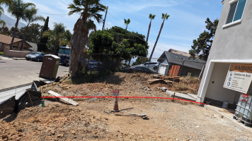

Owner / Builder in San Diego area - The inspector has told me to keep my driveway to less than 20% but when I asked him how I can accompish this or what suggestions he has, he doesn't offer me any advice or suggestions. My level shows this is right at 20%.
What would you suggest? Option 1 slopes down, excavating more dirt versus Option 2 or Option 3 if your feedback, comments?
Property is in San Diego.
Thank you in advance.
Option 1 - this would require a step or two to connect the walkway.
Option 2 -
