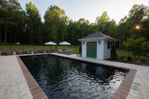

Even with lights, There could be a body down there, and none could see it....pool.png
They got lights.... see the body?
I plastered a few pools with lamp black, I recall one where we were back within a few months for a re-plaster to white.
Some jurisdictions also enforce the WHITE finish, per CA Code Act, with no deviations.
This is so you can easily spot a body in the bottom of pool.
