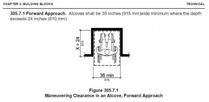

I would say a definite "no" if the door only swings in as shown in the video. Even if the door swings out, it would be difficult for the user to open the door unless it can be easily pushed open by backing up. Both the 2010 ADA Standards and ANSI A117.1 have requirements in their respective Section 604 for "Water Closets and Toilet Compartment." Since this is not a water closet, the requirements for Section 604 would not apply.
Some other questions that are not addressed in the video:
  • Is this the only urinal in the restroom?
  • If it is not the only urinal, is the other urinal considered accessible?
  • What is the dimension between the face of the side partition and the surface of the wall?
  • What is the dimension between the lip of the urinal and the face of the door?
  • Does the door provide a 32-inch clear width?
  • Is the door reached from a forward approach or a side approach? If the latter, it would be unacceptable since the door would open toward the direction of the side approach.
  • Since the door swings at least inward, does the door swing encroach on the required floor space?
There are too many questions, but my initial assessment would be "no" unless it can be proven that it will allow a wheelchair user to approach, use, and leave the stall without any difficulties.
No, it does not negate accessible compliance? Or No, it is not accessible?
You're right, I was answering the question on the video and not Jeff's question.
I would say the door most likely does negate accessibility as I described in my response above. I would not approve the installation unless it can be proven it works for those in a wheelchair.

Does the addition of this swinging door negate accessibility compliance? If so, what code would you cite?
A couple of things I am not sure of: 1 - does the door provide the minimum 32" clear space between the face of the door at 90 degrees to the latch?
2 ADA does not allow does to swing in or over an required clear floor space.
603.2.3 Door Swing. Doors shall not swing into the clear floor space or clearance required for any
fixture. Doors shall be permitted to swing into the required turning space.
Based on the Standards, 2010 ADASAD 605 Urinals 605.1 General. Urinals shall comply with 605.
