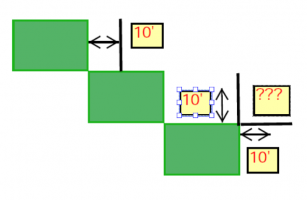

Be careful, or a checker board approach to building houses/buildings on the lot will occur with corners touching and never having to rate any walls because the FSD was measured at 90 degrees to the face of the wall. Interpretation (as allowed by the code by the building official) need to include an arc at the corners so that the following design could not be presented.... if no walls are within 10 feet of the face of the wall at 10 feet, isn't this possible?

BB....The FSD line would have to run between the buildings somewhere and in that situation would have to touch them if it were a true checkerboard, so it would not fly....
  • Like
Reactions: JBI
Correct, but the only way you would get out of it for one building would to be to put the FSD line on the exterior wall of the other building which would raise the requirements on that one.....
You measure at right angles from both buildings to the FSD line, not to the other building, unless the FSD line is on the other building, which would be a 0 FSD for that building with all of those restrictions. Which protects the other building by default...Draw a line at 45 degrees through the corner(s) and in theory, yes, at the corners, there is a flaw, but 1 inch away from the corner there is not....The problem self regulates IMO...
