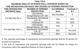

Table 705.8 footnote d.
I think the intent of footnote d. is to permit 25% unprotected and protected respectively as shown in the table; but it seems this line of reasoning would seem to contradict footnote f. where unlimited openings would be permitted for the same condition; UP, NS
Agree with cda, the footnote only applies to R occupancies and the code requires all R occupancies to be sprinkled so the UP (unprotected), NS (unsprinkled) would not apply.
Footnote "d" allows only R-3 occupancies to have a total combined protected and unprotected openings of 25% between 3 & 5 foot fire separation distances
Footnote "f" allows all protected and unprotected opening in R-3 occupancies to be unlimited in size if the fire separation distance is greater than 5 feet
f. The area of unprotected and protected openings shall not be limited for Group R-3 occupancies, with a fire separation distance of 5 feet or greater.
Thanks for understanding my question.
As I understand your interpretation it is allowed to have 25% of unprotected openings where it would not be permitted for other occupancies.
And this interpretation for R-3 aligns with openings not limited greater than 5 ft.
Thanks again for sticking with me on this question.

Then FOOTNOTE F:
It takes some reading around but I gather that the footnote reduces the 10ft or greater to 5ft on the R-3. I believe this to be so it lines up with 601 & 602.
