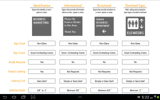

Using the 2012 IBC with the 2009 ICC/ANSI A117.1 codes. Not including elevators; where do either of the two documents require tactile signs? I see what needs to be done if you do provide them (ANSI 703), just not where they have to be provided.

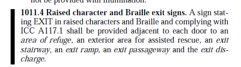

Well, if I understand your question, first;
Then;
Is this what you were asking? That was just a couple that came to me.....
It was 1011 and 1110 in 2003, now that we went to 2012 I am not sure they stayed the same. The majority would be in those areas, but FB point out a good spot where other stuff in is stuck in...
Thanks fatboy that is part of it. I was looking in Chapter 11 when I should have been looking in 10. I was thinking more along the lines of restrooms and other signage. This morning I found what I was looking for in ANSI 703.1.1
703.1.1 Designations. Interior and exterior signs
identifying permanent rooms and spaces shall comply with Sections 703.1, 703.2, and 703.3.
Sometimes you can read something a dozen times and it doesn't sink in.
