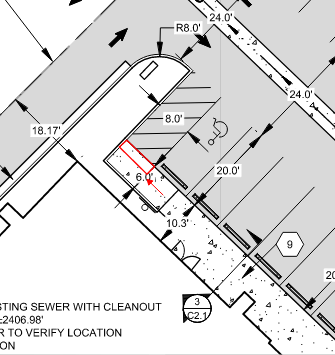

Are Tactile Warning Strips required at all ramps regardless of purpose? The specific situation is a ramp coming from a building door to a van accessible loading area next to the parking stall. The ADA accessible route is only building to parking stall. I am guessing it is required but couldn't find the code that shows this specifically. The code focuses on where ramps are directed into vehicle traffic areas.

This is a project in Idaho. I guess I need to determine the correct term for this case. Maybe a pedestrian ramp and not a curb ramp. It is to a vehicular area (parking stall/loading area) but not into a vehicle travel way. Thanks for the help.

Any chance you can post a picture or link to something similar? If it leads a parking space / access aisle / loading zone, then it probably needs detectable warning.
For what I’m about to say, you need to make sure that you do indeed have a ramp, meaning a sloped walking surface steeper than 1:20.
When that is the case, you want to be careful as to how you treat this, as a “pedestrian ramp” (just referred to as a “ramp” in A117.1) or a “curb ramp” because the requirements are different. For example, ramps require edge protection and may require a handrail if the rise if greater than 6”; curb ramps require neither. Landing dimensions are also different. Sounds to me like you have and want a curb ramp.
Looks like a parallel curb ramp. Yes, detectable warning is almost certainly required here.
Edit: Even if it wasn't a ramp (in which case this would be a blended transition), detectable warning would be required.
