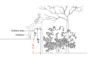

Hello
I am working with a client who is building an outdoor terrace with a wall around the perimeter. They want the terrace wall to be 20" high so that it can be used for seating. There is a drop at one point that is 48" to the ground from the top of the wall (on the side opposite the terrace). I think this is not allowed because of section R312 (see attached picture) in the residential code, but I wanted to see if there were any provisions if this area had trees and/or shrubs as an additional barrier.
If there is no provision for trees/shrubs to act as a barrier, it seems that the only way to do this is to grade away from the terrace with soil so that there is a section less than 30” measured vertically in the 36” measured horizontally adjacent to the terrace. Because in this condition no guardrail (36” high) is required.
The attached sketch shows what I mean. Thank you in advance for your help!

Is this at a single family home?
If this project falls under the IRC, then you are beyond the scope of the IRC. In the IRC, there are not provisions that extend to the building site. Once you are outside the home, the IRC basically stops.
The IBC does contain requirements for building sites given the public access and generally lower level of familiarity people have in these spaces. Hence the increased scope that includes additional provisions for guards.
This is to say, I think you are aware of the hazard here. While the code would not stipulate a requirement to place a guard or other barrier, you obviously understand the risk. You can thereby make an informed decision.
Remember, the code is the minimum standard and not best practice.

What you would like to do creates a 4’ drop from the seat to the ground. A person that falls from the seat will land on their head. A back rest is called for... if for no other reason than comfort.
As classic T mentioned, this may not be regulated by a code however, neither is common sense. They definitely should not go with the top drawing.

Kendra and the rest of you correct me if I am wrong here, but the If I minus the 20" seat height from the 48" drop height, I come up with 28" which is under 30", which is the trigger for a guard being required under the IRC from the walking surface.
Unless Philly adopted something specific and different, measuring from the wall is not in the code, I am pretty sure about it because I was one of the 2 authors that added Fixed Seating during the CTC hearings which was adopted during the CTC's proposals to the code cycles in 2006, 2009 & 2012. That stipulation was removed in the model code by the enforcement sector through proposals and is no longer in the model 2015 IRC and future additions currently.
So as long as the drop from the walking surface to the lower level does not exceed 30 inches within 36 inches, you are compliant per the state adopted and enforced code requirements currently. I would however not push it so close and try to stay under 26 inches from top of wall to ground below allowing more than just 2 inches for future erosion and landscaping, in other words give them more than 2 inches to work with. Just an opinion, not a requirement.
Additionally, based on my scaling the seat is about 15-16 inches wide, and thus

TBZ is right. I glanced too quickly at the drawing and took the 4'-0" as the height of the terrace.
The code might not apply to a terrace located away from a house, but why would it apply to a deck attached to the house but not a terrace?
I would still recommend backrest as a safety measure. If the client refuses it, then tell the landscape architect to specify several soft bushes there to break a fall.
Paul,
I agree with your backrest, and this is what we have done with clients in the past.
