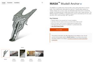

What kind of issues? Issues with installation or design? Or real-world failures?
I've only ever seen them on a few jobs, always new construction and part of an engineered design. They look like they make construction easier and listing wise they're supposed to be stronger than basic anchor bolts.
Typically, we see the basic anchor bolts and SSTB's with HDU's.

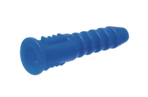

So the real question is how the CMU is grouted when the J or L bolts are installed. I've seen them just fill the cell below with pieces of the empty lime bags and then set the anchor in mortar. Like that is going to do anything.
I once failed a contractor for missing anchor bolts on a portal frame. The trimmers and kings were installed on a sill plate and I could just see the crack of the un-grouted cells underneath. The next day I was back for the reinspection. It was a miracle, brand new anchor bolts, in fully grouted masonry that was not new, with nice big plate washers, on a wider sill plate. Also in plain view was a little slop poking out around the plate washer from some expandable foam cans that weren't there the day before. Because I am the @#$ I gave it a little tug. Out slid the bolt. Turns out expandable foam is not good in tension.
