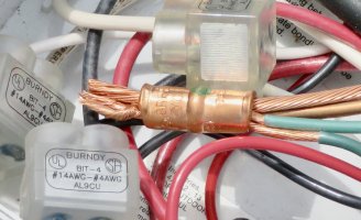

It is not unusual to perform five or more solar inspections in a day. I have been sent to a cities that gave me a dozen. While there has been some improvement, c-taps are a common problem.
