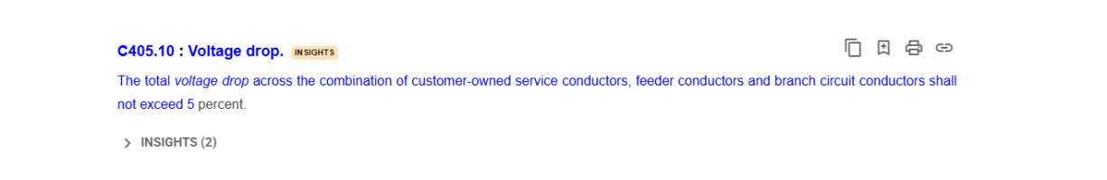

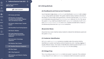

Check out California's requirement on Voltage Drop.
Oh, I see it is in the 2020 NEC also. But is that exclusively for Sensitive Equipment?
Andy.
